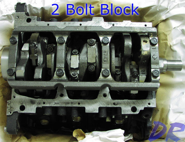

prave vtom CAPSU uvidis jake dily jsou spolecne a ktere ne. Rozdil mezi prvni generaci a druhou generaci je hlavne vtom ze uchyceni klikovky u
1 generace na 8 sroubech a generace druha ma 16 sroubech, dale v uhlu otevreni valcu do V, druha generace nema uz nastavitelnej snimac vacek na predstih, jine kolen vyf. potrubi, olej. vana a spoustu drobnosti atd atd

The DOHC 6G72 is an extremely strong engine, with an alloy steel block and aluminum alloy heads, and is capable of delivering well over 500 HP with turbocharging. As good as the first versions of the engine were, Mitsubishi decided to make the engine even stronger in 1993 models (starting with June 1992 production-date cars) giving it a 4-bolt main bearing cap girdle (the original used 2-bolt caps with stiffening stays on the middle 4 bolts) and a nitrided-steel crankshaft (the original was cast iron or mild steel). Mitsubishi made other changes, most significant of which was moving the crank and cam angle sensors from the left head (where it was user-adjustable for timing) and into the block (not adjustable). Major lower-engine parts that remained the same include the piston and pin assembly [MD307972 is listed as the standard-size replacement for all years] and the forged-steel connecting rod assembly [MD131329 is the only part number listed for all years]. Because the newer nitrided-steel crankshaft [MD318150] is listed as the replacement part for all years, it is possible to upgrade the "2-bolt" blocks with the better crankshaft (~$600-800 new). Clevite 77 bearings are an excellent choice to upgrade the stock main and rod bearings. As long as you have the engine apart, you might consider upgrading to forged aluminum pistons - 6G72 piston upgrade guide.
I gathered the information below to assist the Z16A (turbocharged) 3000GT/Stealth enthusiast in converting the 1991-1992 "2-bolt" block to the 1993+ "4-bolt" block. This is not an engine swap and so does not involve or require any changes in the wiring harness or ECU. The 1991-1992 heads are retained, including the adjustable crank/cam angle sensor. The parts listed below are required to replace the 1991-1992 "2-bolt" block to a 1993+ "4-bolt" block, while re-using some of the old components. Supposedly, complete "4-bolt" blocks (short block assembly) can be purchased for a bit under $3000 from Mitsubishi dealers.

edace2416d9e7f12c9f01e934ab9dce1.jpg [ 72.3 KiB | Zobrazeno 7113 krát ]
